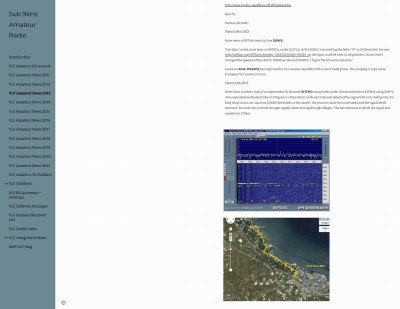

Dal pregevole Sito di Roger Lapthorn - https://sites.google.com/site/sub9khz/v ... -news-2013
8970_Hz_20130311_IK7FMO_Earth_mode_4_Km_Roger_Lapthorn_Forum_ADIA_Astronomia_1600.JPG

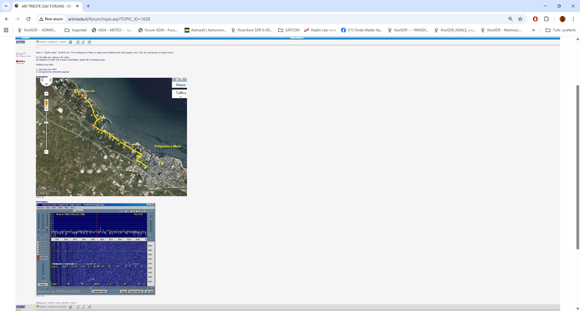

Dal Forum ARI Trieste - http://www.aritrieste.it/forum/topic.asp?TOPIC_ID=1638
